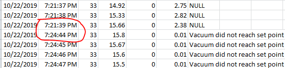

I made a program that essentially power cycles a vacuum pump for thousands of time and I record the vacuum from a transducer once every second.
When I ran the program, it stopped because the vacuum did not reach a certain set point within a certain amount of time.  I reviewed the text data file to see when this event occurred but noticed that the program did not record this event.  There is a 3 minutes segment in the data file that was not recording where I think the failure event occurred ( see screenshot below).
The way I have my program setup is, I have three loops running parallel.  One loop to acquire all the data, a state machine loop, and a data recording loop.  In the data recording loop, I just put a "wait" function in the loop so that it only loops once a second so that I can record only once a second.  Maybe this is the wrong technique.
Haven't looked over your project in much detail, just guessing here. Does your failure/error event throw a dialog? If so, you may have a case where the "root" loop is preventing other loops from running or your dialog is waiting for a response and that is preventing your loop from running. (Google root loop and LabVIEW.)
I typically make my own dialogs and call them asynchronously to prevent any blocking conditions unless I explicitly want to freeze the loops waiting for a user response. For example, if there is an error, does the user want to ignore and continue or exit the program. This would be a blocking call. If I just want to inform the user that the disk is almost full, this may be a non-blocking call. (I turn off logging automatically when the a certain disk threshold is reached.)

  • Is the issue reproducible? A short video recording of the issue will be helpful.
  • Is the file data which you were showing is collected in a single run? If yes then one of the possible reason could be the record button wouldn't have been selected during the time when the data was missin.
  • Do you have any popups that were popping  out during that time?
