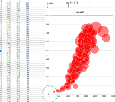

I would like to make the marker size in a 2D scatter plot changed as a function of a third set of data.  I am already using color as a separate fourth variable.
Here is an example plot of what I am looking for.

you are looking for a bubble chart
@Bob_Schor wrote:
Probably better to use LabVIEW to gather the data and send it to a more general Plotting routine that can "export-back" an Image that LabVIEW could display.
I would create a graph like this via LibreOffice
