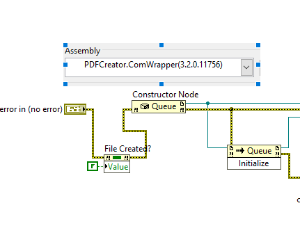

Your instructions got me 80-90% of the way there, thanks. But I could not link to PDFCreator.exe.
I found the following worked for me with ver3.2.0.
Maybe this will help the next person.
barry
