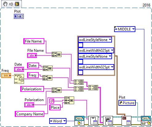

I'm writing the data into word document and not able to format properly.
In the document 1st line is "Tittle", 2nd line is "Place", 3rd line left side is "File Name" and right side is "Date", 4th line left side is "Freq" and right side is "Polarization".
Kindly help me where I have to change in attached VI to achieve the above requirement.

I am able to create the table with no borders. Why vertical line is showing in between the columns and I am not able to do the column wise alignment. And how to save this document as .pdf.
Please find the updated snippet and help me in above issues.

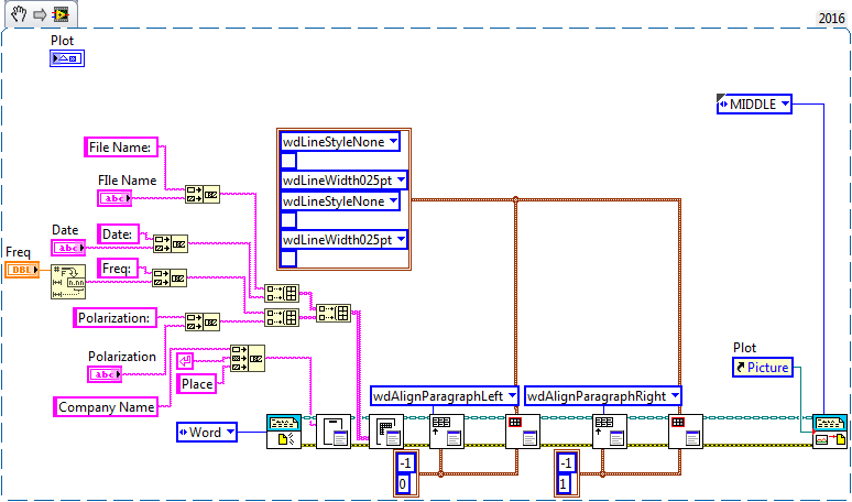

I don't know why but wdLineStyleNone only applies to external border and horizontal separation lines. You can get rid of the center vertical line by formatting the left column then the right column.
