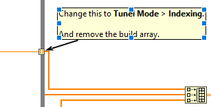

I made a little change on your VI.
Hope it works properly now.

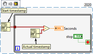

maybe this would work for you

  • Your program is doing exactly what you told it to do.  You wire a TimeStamp into the r0 of the Waveform Cluster (a reasonable thing to do), and plot it.  Did you notice the appearance of the Chart on the Front Panel?  Do you see the default Time value, which shows 7 pm, 31 Dec 1903?  That's a representation (by LabVIEW) of a TimeStamp value of 0, which tells me that you are (probably) in the Eastern part of the US (or at least on EDT), as LabVIEW TimeStamps are in seconds from 1 Jan 1904, UTC (5 hours ahead of, say, New York City).  If you want to plot Relative Time, open the Properties of your Chart and change Time from Absolute Time (Date + Time on the clock) to Relative Time (from 0).
  • If you want to save Relative Time, save the Starting Time (I won't call it t0, but how about Time 0?) and save as t0 (TimeStamp - Time 0) in your Cluster.  [I hope you see that's the number of seconds between the TimeStamp you just read and the TimeStamp you saved as Time 0, i.e. "elapsed seconds"].
