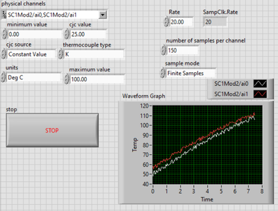

Can someone help me solve the problem of data refreshing?
I have to continuously acquire the temperature data till I click the stop button.
But my data is refreshing after every 7.5 seconds(Rate=20hz, No.of samples per channel=150).
How to add or collect the previous data continuously without refreshing for say complete graph for 2 minutes but not only for 7.5 seconds.

1. Use a chart instead of a graph for display
2. Write results to a file for future use.
If you open the file before the loop and write to it inside the loop using a file refnum (not a path), you can read something more like 5 samples per loop to keep your UI more responsive to your Stop button clicks.

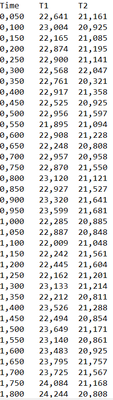

Hello Kevin,
Thanks for the response, but still I'm collecting the data only for 7.5 sec as mentioned,
Also while using the waveform chart I'm not getting X-axis in seconds as in the waveform graph.
If possible can you please share the code?
Is it possible to get the output continously as shown below?

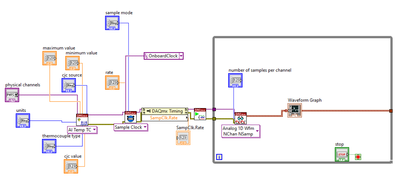

You are using finite samples and depending on auto start to retrigger the next acquisition.
Better practice would be to use continuous samples,  set samples to read at "-1" and throttle the loop with a 200msec wait for next ms multiple. Your users will thank you.
And as Kevin mentioned,  enable TDMS LOGGING! with concurrent read to save the data you worked so hard to collect.
  • Your loop should exit on "STOP or Error!"
  • The Task and error cluster should be on Shift Registers.
  • You need to add a stop task and a clear task after the loop for Appopriate cleanup.
  • The last function should be a simple error handler.

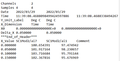

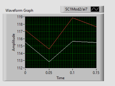

@jay I have implemented as you suggested to use continuous samples,  set samples to read at "-1" and throttle the loop with a 200msec wait for the next ms multiple, but it is just refreshing at from 0 to 0.15 and also i can just save only three vales
@kevin,I have also followed the suggestion you made but still, there is not much change, also i have implemented the second example you sent, after everything it is still refreshing the data.(For N samples and Continous samples).
Can someone send me a screenshot of your code if possible to acquire the continuously without refreshing.
Rawoof
(2,340 Views)
Looks like you're still using a *graph* when it sounds like you'd want to be using a *chart*.   As previously mentioned in my initial response, msg #2 in this thread.
-Kevin P
(2,328 Views)
