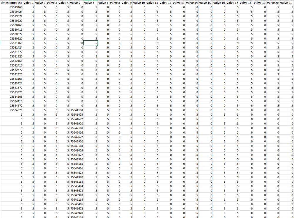

Data shifting in Target to Host FIFO when written to TDMS (LavVIEW 2015)
I am reading values from a NI 9205 module on a cRIO-9068. When I read the values and display them in the front panel for the FPGA VI everything looks correct. When I look at the values on the Host side the values shift around. An example of the TDMS file and the shifting is included below. All values are constant and shouldn't be shifting between rows:

It is impossible to debug a picture of a spreadsheet.  Attaching a VI of your code, that would help in debugging.
My guess is that you are missing data in the FIFO.  Perhaps it filled up before you had a chance to read it.  Pure speculation at this point.

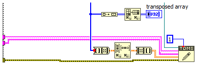

2.  I don't understand all of the array to matrix to array manipulation you are doing before writing to a TDMS.  No need to convert to a matrix at all.

I am aware most of it is probably unneeded but as this is my first experience with labview (background as an embedded sw engineer) I am using it to keep things straight in my head. Once working I will go back and remove what isn't necessary.
The conversions are there because I couldn't get the 1D array written to the TDMS file without the use of this and the standard transpose I found on the forums didn't work.

You can't transpose a 1-D array.  You can only transpose a 2-D array.  You can turn a 1-D array into a 1xN 2-D array.  (1 row by N columns) by using the Build Array function, then transpose that into a Nx1 (N rows by 1 column) 2-D array.  (See top half.)
test_stand_BD

I made this update and was able to remove all of the unneeded transform functions but the problem with the time-stamp field moving through the data (column shifting) is still occurring.
Message 9 of 15
(4,518 Views)
I think I have made a bit of headway, if I lower the time I wait between checks on the Host side to not having any it seems to stay correct for longer until things get out of sorts.
This leads me to believe it is an issue with TDMS file output not being able to keep up with how fast I need to be polling the data. Does anyone know of a way to buffer the polled data from the FIFO until either the end of program execution or to write/flush to disk at a slower pace?
