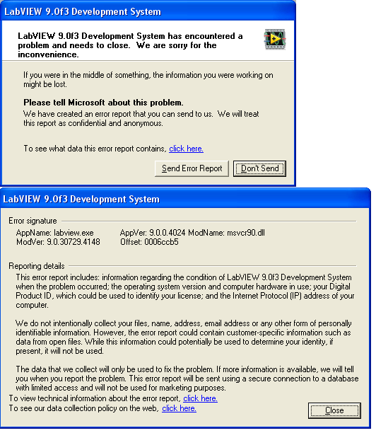

Here is the Microsoft error I get
18891i33BC9EEE04DC0CCA
It has to do with the MSVCR90.DLL. I looked for problems with this library on the discussion forums but no one came up with a solution.
