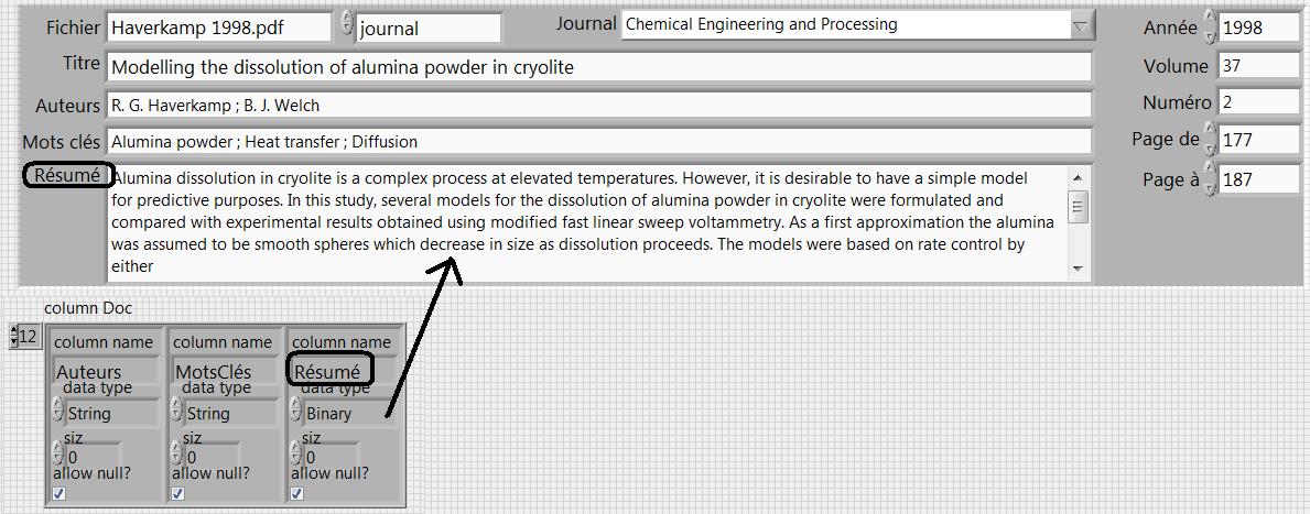

I just began with the utilization of database and I created a small database (with the database toolkit)  for technical papers and patents.  To store the abstract I use a binary type.  I want to know if it is possible to make a search in this field (i.e. SELECT * FROM Documents WHERE Résumé LIKE '%alumina%' AND Provenance = 'journal'; )?

Yes, but nothing is found (there no error):  I am supposed to have more than 25 hits.  I used the binary field only because I am limited with 255 characters if I take the string type.
If I made a query in others fields, everything is fine and I retrieve all the data.

I utilize Access.  I solved my problem with the use of "memo type" instead of binary type.  I was able to create a table with "memo type" by modifying DBToolsCreateTable.vi (it is not elegant but it is working).  To insert a new record in the table, I use "DB Tools Execute Query.vi" instead of "DB Tools Insert Data.vi".
