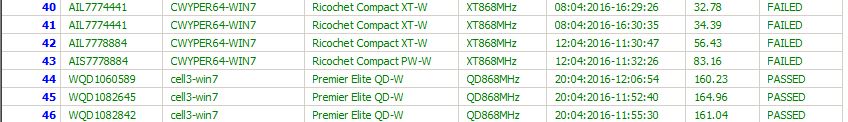

In Column 3 is the computer name. So it works on different computers but with some you are getting this error:

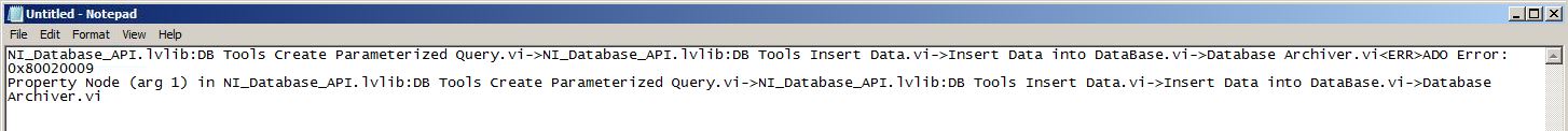

I have set up the odbc exactly the same on my pc, the pc that is working on the production floor and the ones that aren't working. Why is it im getting this error on certain machines and not all of them? I have attached the VI's (I know they are messy and ill clean the wiring up once its all finished and working on every machine).

Thanks for the reply. I have searched the error and its talking about follows:
"ADO Error 0x80020009 refers to an EOF, of sorts. It essentially means your query returned no results or you reached the end of your record set."
All i'm trying to do is insert the data that is on the pc's onto it without actually having to manually enter it. I have tested multiple times on my pc and the code works perfectly fine. I never get this error message. I tried it on a pc downstairs and again it worked fine. Then i tried putting it onto multiple computers and then started getting issues. But regardless it still works on the computers that worked.

I wouldnt say so, the names all vary, all that i can think is that there might be a permissions issue and its not allowing the computer to run correctly.
