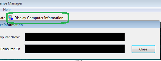

  1. Open License Manager
  2. Click "Display Computer Information":
  3. call customer support.  have the computer information handy.
The AE will remove the activation entry and give you futher instructions.
