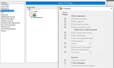

For release build I ended up doing:
- compilation level 10
- disable debugging
- tend to remove error cases when placed inside subvis, hard to read this just pass the error instead, native functions will not execute on error anyway
- place all project structure in one common root virtual directory containing all source VIs and uncheck allow debugging on this folder
Is there something more that can be done to ensure full optimization?

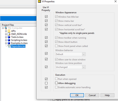

Thanks for reply, I think debugging on VIs is enabled by default so all good there.
For dependencies I can simply set this flag in build spec as follows?:
So according to this doc, building app does not actually recompile all source code?
The deeper I go the more confusing it gets.

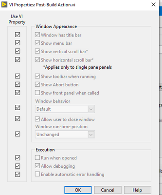

Correct, setting the build specification properties to debugging DISABLED and the individual VI property to debugging ENABLED (default setting) forces a recompile during building.  The forced recompile is beneficial only if the compiler optimization setting has been increased.  This option can be manually set beforehand in LabVIEW options or can be incorporated into the build specification by creating a "PRE-build action VI" that uses scripting nodes to programmatically alter the compiler optimization setting (set to 10, highest).  A "POST-build action VI" can be used to return this setting to 5, which is the default.
