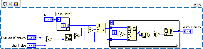

Not really Rube material, but it feels a bit inelegant to me.  I chose to pad the input array, you could also truncate if you wanted.  This will let you specify the number of arrays (2 in your case) and the chunk size (5).  The output is a 2D array where each row corresponds to one of the desired arrays.

Awwww, Darin.  You went and did his homework for him. Smiley Sad  How is the guy going to learn how to code on his own?
- tbob
Inventor of the WORM Global
(4,497 Views)
I know of no better teaching instrument than a well-written example.  If the OP figures out how the code works he'll learn plenty as far as I am concerned.  His history gives me no indication that he is looking for us to do any of his work.  Last I checked, LV ships with a ton of examples so they must think it is a good thing (even if many of them are sketchy).
LV itself is very easy to learn, what is harder to teach and learn is the thought processes that go into problem solving.  In this case, he should be thinking beyond two arrays with a fixed chunk size of 5 and instead thinking early on about code that is adaptable to other problems.
As an added bonus, this way someone else can post their version which makes mine look excessively complicated and I get to learn as well.
