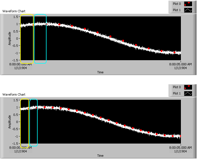

Hi RPJ,
I use 'last' method because this method picks the last sample every M samples, where M is the decimating factor. In other words, the decimated sample is one of the input samples.  So you can easily check if the resulting decimated array aligns the input array.
For other options, I think there is one assumption that the input signal should not change much in one demicate interval.
First, I want to understand your word "However, if you change to 'mean' value then the red dots (decimated waveform) do not align timewise with the original waveform unless you use a decimating factor that is a submultiple of the samples read per channel for example 250."
To me, there is no difference between 400 and 250 decimating factor.
For example, in my VI, the input signal is sine wave, if you use 400 decimating factor, and use 'mean' option, the result is as follows.
The VI averages the first 400 samples (in yellow rectangle) to get the mean value (the first red dot), and I put it align with the last sample of this interval.
Then the VI averages the second 400 samples (in blue rectangle) to get the second mean value (the second red dot), and I put it align with the last sample.
If I use 250 decimating factor, the result is as follows.
Both of them seems not close to original waveform.  This is because they don't meet the above assumption - the input signal should not change much in one decimate interval.
Then see another example.  The input signal is slowly changed, and with some noise, like the real signal.
With the slowly changed waveform, I still use 'mean' option. Decimating factor is 400 and 250, respectively.  I still align the decimated sample with the last sample in that interval.  The result is more acceptable.
Thus, my opinion is,  if you use any option other than 'last', the input waveform should meet the assumption. If so, then you can align the decimated samples at beginning, at center, or at end of the decimate interval. This does not matter much.
For your second question,  at least you need to record the t0 for the first decimated sample when you start decimating or reset decimating.
But to be safer, you can log the decimated waveform to the file. Just append the data to the file in each iteration.

If you look at your second example, the one with the 'real' signal, for the one with the 400 decimating factor, there is no red dot where the waveform ends (at the right end of the chart). I would suppose this is because there are a number of samples left that are less than 400. I can live with that. For mean, median, minimum, or maximum I was not concerned that the decimating signal is not superimposed over the original waveform in terms of amplitude (Y axis) but in terms of time (X axis); the amplitude will definitely be different if you use mean, median, minimum, or maximum. If you use 'last' the point should belong to the original waveform both as amplitude and time.
I will try to implement this solution to my case and will share with you the result. It may take a while but be sure I'll be back.
Have a good, relaxing Labor day.
Message 17 of 18
(2,165 Views)
Hi RPJ,
Yes, you are correct.
In the second example, there is no red dot at the end of the waveform, since the left samples are less than 400.  Because the Sample Compression VI does not know if there will be next block data coming or not.
If you do the decimating block-by-block, this may occur at the last point of the last block data.  This needs special processing for the last block data.
Look forward to your result!   And have a great Labor day!
