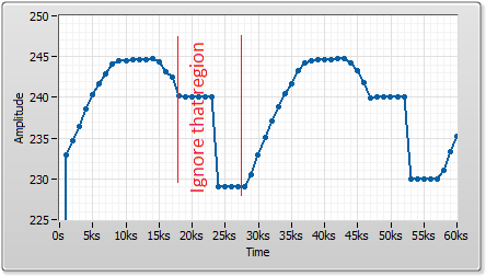

Hi Wiebe, Henrik. First, thanks for the answers, I am providing an example data set of the data to decimate.
The delta time is not precise and irregular, however this normally has a pattern; 10, 10, 20  seconds and repeat for example, however the time can jump a couple of hours in time intervals. I don´t have in mind a specific method to decimate the data but I would like to only show data blocks of near points and avoid to include points after the time jumps to organize the data and be easy to follow the order.

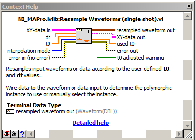

You may want to  try the Resample Waveforms (single shot).vi
That VI is polymorphic and accepts XY data as input (just not Timestamp values so keep the X-array as DBL format).
The VI returns resampled data at constant dt intervals both as XY and waveform data.

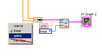

Note that the FIR resampling mode does not apply for XY data (it defaults to Linear interpolation). Try for example Linear and/or Spline interpolation methods with dt input values between 100 and 1000 sec.
Also note that due to the nature of your data (with discontinuities), the spline method will insert samples that are significantly 'undershoot' but if you ignore these you may still get relevant data.

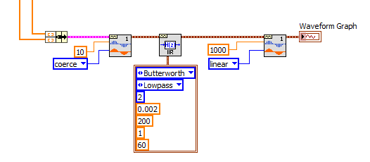

Actually in your specific case you can create a more advanced algorithm to solve your problem. Here is an example where I
1 - resampled your XY data using simple coercion to give me a evenly spaced waveform with a high sample rate (dt = 10)
2 - applied a smooth lowpass filtering to your signal
3 - decimated more than 100 times (dt = 1000)
I could have used a FIR Filter based resampling instead of independent lowpass filtering an resampling, but that would give more overshoot and ringing around your discontinuity points.
Just some ideas...
