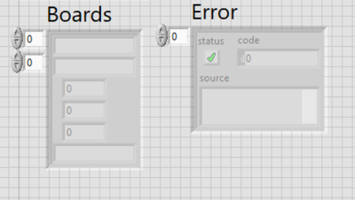

I don't get it, can you explain? I'm passing the iterator to the "Insert into array" function... this will not work? Of course the VI was not  'returning' the resulting array I'm working on this but I got some unexpected results:
But in the front panel ...
Why they got two indexes? It looks like boards is 2D....
And also error has become an array of errors....????

You have created an array with 'initialise array' and for each file you are reading you are trying to insert the cluster into an 1d array. At the end of the for loop this 1d array is indexed into an array of these 1d array forming a 2d array.
This is a mix of a few methods, and you need to choose one.
You can create an array the correct size for the number of files you are reading and insert the cluster into the array. But the second iteration must use the array as it was left after the first interaction of the loop. To do this you need to use a shift register on the array terminals.
Alternatively don't initialize the array at the start and let the for loop build the array from the cluster using the indexing output terminal.

You have created an array with 'initialise array' and for each file...
oh ... yes... I meant to put the initialization 'outside' the loop not inside it...  I'm fixing that:
I'm not sure this's what you meant but now the function does what I meant... (at least it looks like so).
This's the front panel now... much better now!
For some reason also error has been fixed....
