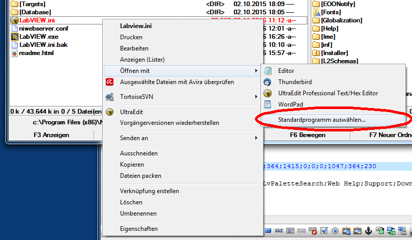

Just to be sure, we talk about the same procedure of setting the default program (shown on my german windows installation):
First:
Start the Windows Browsing Tool of your choice as an Administrator!
Second:

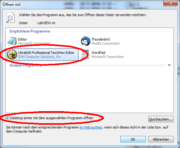

Third:
Make sure to set the checkmark at the lower side.
That should do the job.
