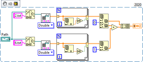

actually i solved the problem as the attached .vi.
but if you have something simpler please guide me

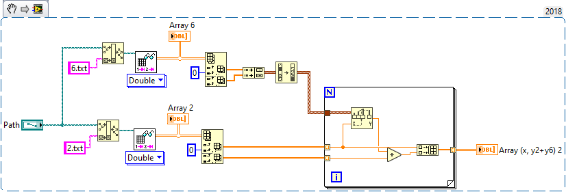

This seems to work.

In the OP case, the array's x values are identical after deleting the start values that are less than zero. Here is another version that's a little more generic. In my particular applications, I cannot guarantee that all x values are identical between the two arrays (i.e, adding antenna gain to a frequency spectrum).
