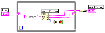

All I did is to search the string with vowels. then i dont know what to do..

  • You code has nothing to do with vowels, right? What was your thought process so far?

i'm completely newbie in LabVIEW. i have just joined in labview coaching just before 2 days.. and what my Plan is as the consonants are more in number, we cant search all the 21 and then delete them as it may take huge scanning time and memory.. so i have decided that i can search the  vowels instead and delete them and place the remaining outputs in a result string. and sorry i have posted a wrong image.

Again, insert images, instead of attaching. Also please crop to only show the interesting part. We really don't care about your task bar and all that whitespace.
Your image still makes no sense whatsoever. It just repeats the same identical operation 5 times as fast as the computer allows. You would get the identical result if you delete the FOR loop. We also don't even know the contents of your controls. Why is the "Search string" terminal inside the loop? Do you really think you can enter new values during the few nanoseconds the loop is executing?
Attach your VI. Make sure the controls have typical default values. Also explain what result you expect. Has your teacher already told you about auto-indexing and shift registers? If so, go over your class notes again.

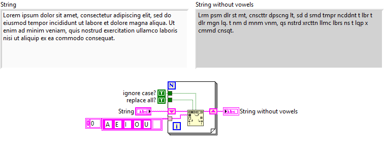

Accepted by topic author badshahsatya
Here's a quick draft to give you some vague ideas. Make sure you understand the purpose of every single code element (For example the thingies with the pink triangles, the tunnel with the [], the string array constant,  etc.).
First try to implement it verbatim from scratch and see if it does what you think it does, then try to rewrite it to remove consonants instead.
