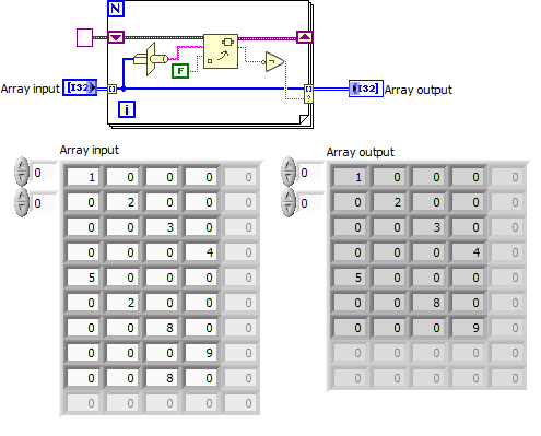

Well, you need to compare each row with all the rows already looked at, which can get very expensive once the array gets long. For small arrays, explicit comparison would be no problem. What have you tried?. For larger arrays, I would use a FOR loop and cast each row to a string and use variant attributes to check for duplicates. Much more efficient (logN vs. NxN).
Here's how that could look like. Make sure you understand how it works. 😄
(For an even better solution, come to my talk at NI Week 2019 :D)
(4,081 Views)

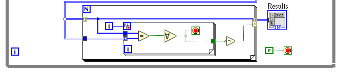

For completeness, here's a simple solution without variant attributes. Good enough for small arrays, but inefficient once the number of rows gets large. There are many other ways to do all that, of course, but they probably require more code (shift registers, case structures, etc.).
(Note That you cannot invert the logic and termination condition to avoid the NOT, because in the first iteration the inner loop iterates zero times and outputs a FALSE.)
I recommend the variant based solution above!
You did not say what the datatype of the array is. If it is orange, you potentially need to worry about handling NaN, because they would throw a wrench depending on what you expect from the comparison. (Generally, NaN != NaN 🐵
(4,061 Views)

No, just right-click the equal comparison and change to "compare aggregates" comparison mode. No need for "and array elements". 🙂
Both versions run fine here, so to see what's wrong with your variant attribute solution, show us what you did. I am sure you overlooked something simple.
