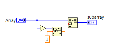

Another way, without a FOR loop.  Finds the first nonzero element and deletes everything up to that point.
This will only work if the first nonzero element is close to 1. If the first nonzero element is e.g. 10000, threshold array used in this manner will give the index of the last zero element.
Here's another alternative.
