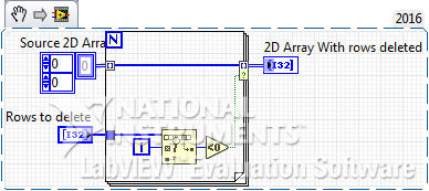

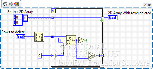

Adding a "Super CA" ModSmiley LOL Just because I can always do better
