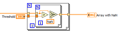

To replace with NaN,  use a stack of two FOR loops and autoindex on all boundaries. Do the comparison in the inner loop and use a select node to modify.

Here's what I might do:
