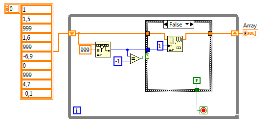

How about this code?

Just to be sure, my code was built using:
- While loop
- Search 1D array
- Equal?
- Case structure
- Delete from array
Br,
Peter

Hi Peter,
did you notice your RubeGoldberg-construct already?
One (slightly) improvement:
- Keep in mind: Using "Delete from Array" isn't very efficient when it comes to big arrays and a lot of elements to delete.
- Keep in mind: You get trouble really fast when trying to compare float numbers for equality. There are a lot of threads on this topic.
- Keep in mind: Search1DArray has an index input. This could help speed up the shown snippet.
Message 6 of 12
(3,792 Views)
Hi GerdW,
I tested your code but it doesn't work.. or maybe I was wrong?
Message 7 of 12
(3,787 Views)
Sorry, you have to swap TRUE and FALSE cases...
Message 8 of 12
(3,783 Views)
Try this.
Good luck
Message 9 of 12
(3,780 Views)
Ok both solutions work.. Thanks 🙂
But what's any flaw with GPeter solution?
