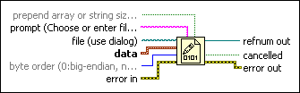

You could better store the data different.
The Write to binary file function has an input 'Prepend Array or String Size'. This default to 'True' changing this to 'False' will eliminate the additional 4 bytes.
