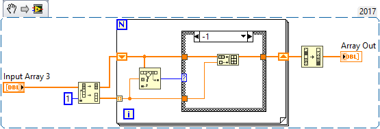

Try this.  The first element in any array cannot be duplicated by default.

  • You have a 1D array, not a 2D array.
  • All values seem to be integers, so why do you use an orange datatype? With DBL, equality is difficult.
  • "delete from array" is dangerous unless you delete the last element, because all indices of existing elements change. It should never be used repeatedly in a loop.
  • Have you heard of the conditional output tunnel? It would significanlty simplify your code.
  • (I would probably use a variant attribute base solution.)
Message 4 of 11

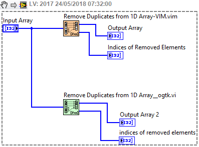

As said before, if you have integers, change the data type of your input 1D array to I32.
If you use LabVIEW 2017, there is a VIM to do this for you in one step. If you have earlier version of LV, you can download the OpenG Arrays toolkit from VIPM, and use that:

Just for the reference, the above mentioned vim is not an NI one, neither exists in LV2018. I totally forgot that some time before, I installed a package from LAVA, so that vim is from Hooovahh:
https://lavag.org/files/file/296-hooovahh-array-vims/
