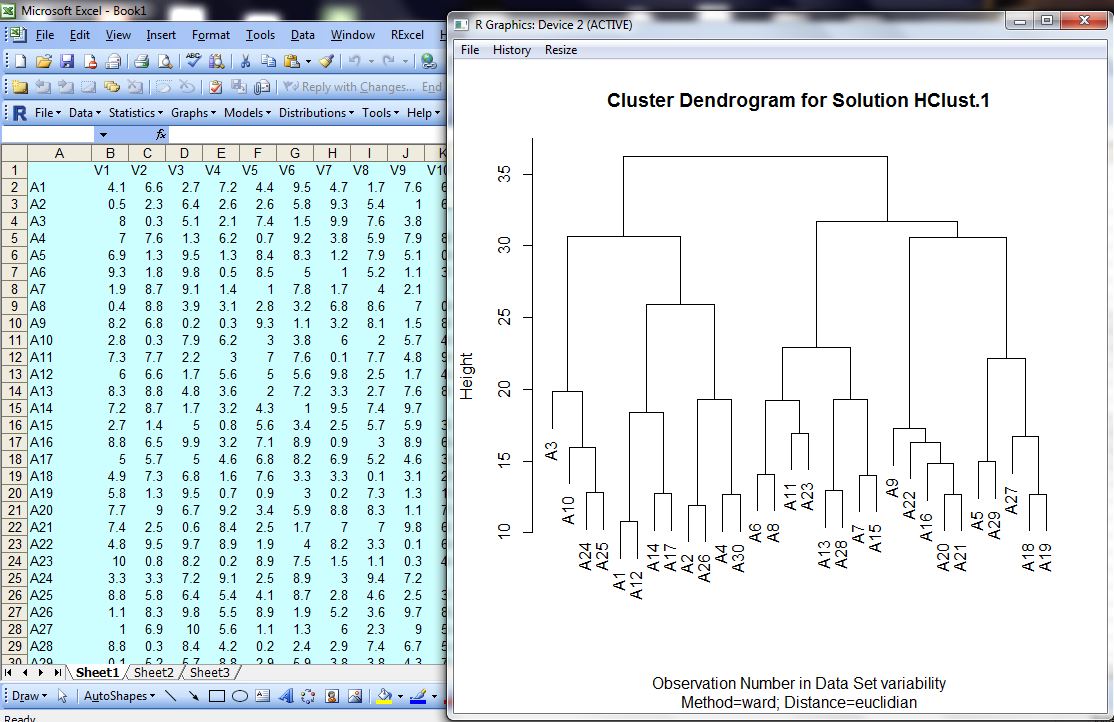

If this was a project on my desk I would investigate adding an ActiveX container to a FP, imbedding an Excel page and trying to get the example shown here
to work.
it could also be done(as Christian posted above) using a LabVIEW Picture control   but first I would see if I could cheat and use the Excel approach.
