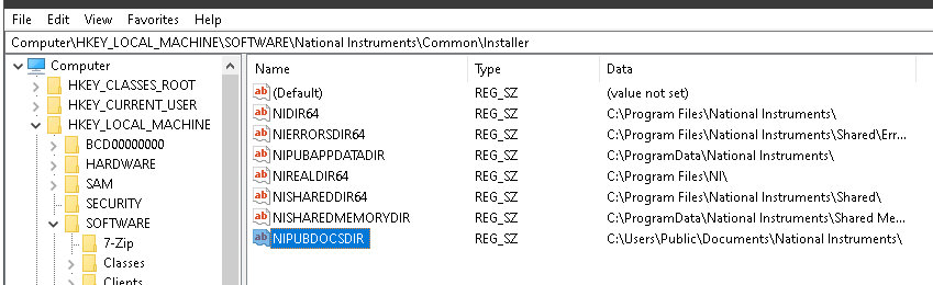

Check for the presence of this registry entry:
Computer\HKEY_LOCAL_MACHINE\SOFTWARE\National Instruments\Common\Installer
NIPUBDOCSDIR
Expected string value: C:\Users\Public\Documents\National Instruments\
If it is not present, try adding it and restarting labview.
