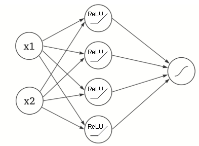

It’s actually quite straightforward. For example, let’s train a simple XOR network with four neurons in the hidden layer:

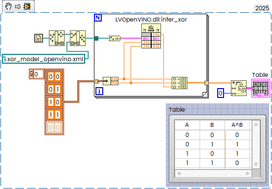

And here’s how it’s used in LabVIEW:

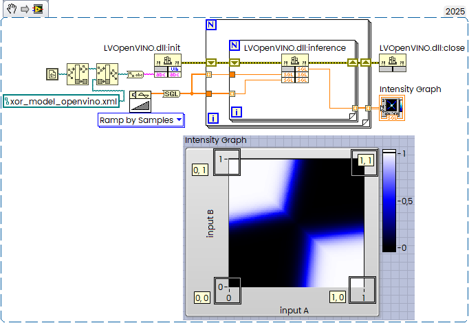

Then you can use it, for example, to explore how XOR network work under the hood:
