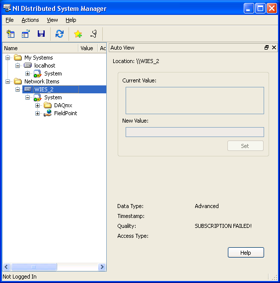

I do now (thank you), but honestly I can't see anything at all.  I probably should have mentioned this earlier (oops), but I don't see anything when I click on my target in the DSM.  There are no tabs in the Auto View, just a location, empty current and new value boxes, a Type of "Advance", and a Quality of "SUBSCRIPTION FAILED!".  So probably the whole DSM communication isn't working at all.  In my defense, I've never used it before, so I didn't know what it was supposed to look like, so I didn't realize anything was wrong.
So, any ideas as to why I'm not seeing anything I should on the DSM?
-Joe
P.S.  This seems like a good time for a screenshot!  Smiley Happy

@ jmorris
I think what you see is fine. The only thing missing is a user defined process that hosts variables.
option1:
Now you can manually create a new process on localhost or \\WIES_2 (via the context menu) and setup your variables.
option2:
Deploy your <sve_process_name>.lvlib file via the project explorer or programmatically to one of your targets.
Hope it helps
Christian
