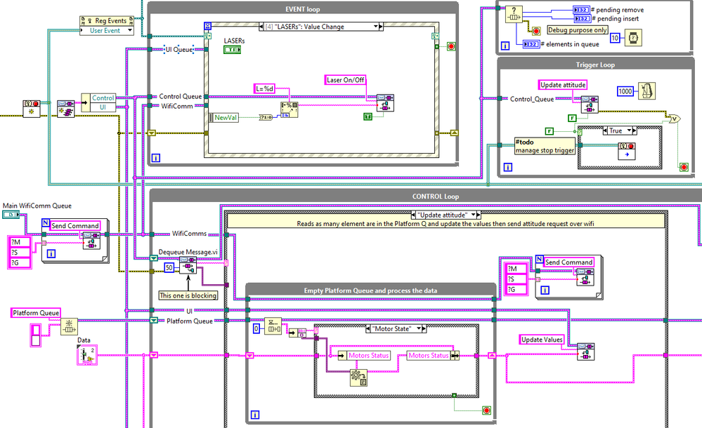

Long story short: I have a SubVI (CoG.vi) based on the NI QMH template and at some point the Dequeue Message.vi in the processing loop is blocking while having its Timeout input wired to 50ms without generating any errors. I spent hours trying to understand what can cause it, and surely I'm missing something dumb but I can't figure it out...
It's very tricky to share any any code as I would end up sharing almost the whole project for it to work, but here is a summary of my problem:
  • Two VIs at stake: main.vi and CoG.vi. Main is calling CoG under user request and isn't blocking Main (takes 1 input, has no output)
  • 4 loops: Event, Control, UI, and Trigger loop (this one regularly send a "request for update" message into the control queue)
  • 4 Queues:
    • Control and UI Queues (created, managed and released withing CoG.vi)
    • Main WifiComms Queue (Created and released in my main.vi, wired as input to one terminal of CoG.vi and is used to communicate Commands from CoG to main.vi
    • Platform Queue (created and released in main.vi, named queue as in it is not a threaded inout to CoG.vi but is called by it in the init process, serves as Data transfer from main to CoG.vi. I was talking about this in this Thread.
Here is the general idea:
- When called, CoG.vi inits Control, UI and Platform queues and starts the different loops.
- The trigger loop sends the message "Update Attitude" in the Control Queue.
- Control Loop dequeues it and send a message with an appropriate command into Main WifiComms Queue and "awaits" an answer from Platform Queue (Timeout of 0 ms, will read next iteration if empty at the execution)
- Main.vi dequeues this message, process the command and then sends back appropriate data over the Platform Queue (via a data management loop)
- CoG.vi receives this data and process it accordingly.
All of this goes fine and you can see it in the following screenshot:
The CoG.vi

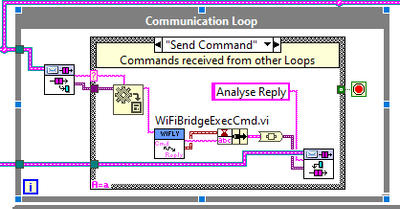

The main.vi comms loop:
Now, whenever I click on the Lasers Button for instance, for some reason the Dequeue Message.vi in the Control Loop will block. It won't generate an error (I know, I don't have any error management yet, but I checked) it won't timeout. In debug mode I can see the green arrow showing that it is executing.

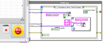

After clicking on the emergency button, this one sends a command directly to the Main WifiComms Queue (not the control queue) which, for some reasons, suddenly unblock the Dequeue Message.vi in Control Loop and starts dequeuing all element in the queue.

In LV 2016 the dequeue doesn't have a timeout input. Did you add this yourself? Did you wire up the timeout inside the subVI?
It's really hard to debug a picture. Can you make a copy, strip out everything hardware related / proprietary, and zip it up?
(2,909 Views)
Wire up a "Get Queue Status" (and wire true to the return elements input) and look at the number of elements in the queue.
