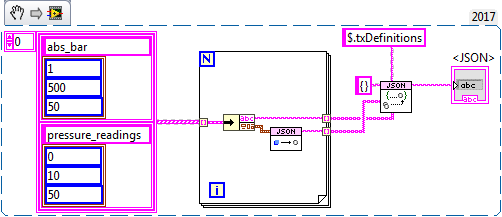

I've attempted to deserialise it using this logic, trying to use an array of clusters of string/cluster pairs as a "pseudo-dictionary":

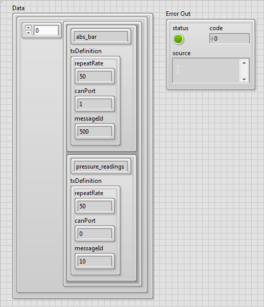

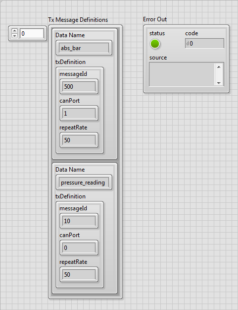

What I expect to get:

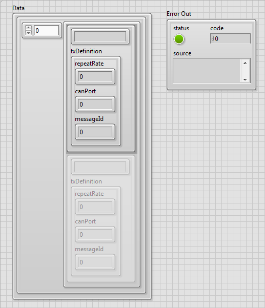

What I actually get:

@JKSH from the GitHub issue provided a really neat solution. I've implemented it below:
From the front panel, I confirm it works even if the fields are in an arbitrary order like in the VI snippet posted above:
Edit: this isn't quite right yet. Fields are mixed up - I need to use the JSON deserialisation library again on the second step (within the for loop) to fix this I think.
Edit 2: fixed this by chucking `Adapt To Type.vi` in the for loop.

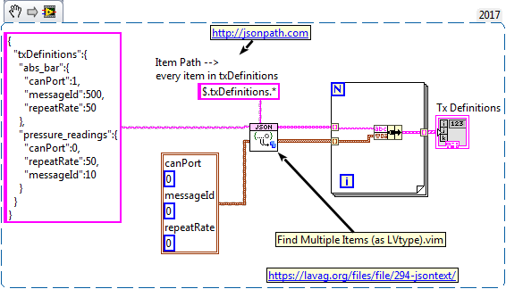

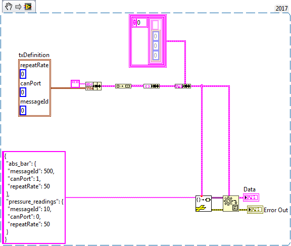

This problem shows one of the difficulties of working with current LabVIEW JSON tools, that are easy to use with fully defined data clusters but more of a struggle otherwise.  I’ve made a new library, JSONtext, that I hope to make working with JSON easier.   Here is your solution in JSONtext:

The reverse problem is also easy (should that be needed):
JSON with variable object item names.pngJSON with variable object item names.png

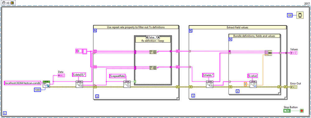

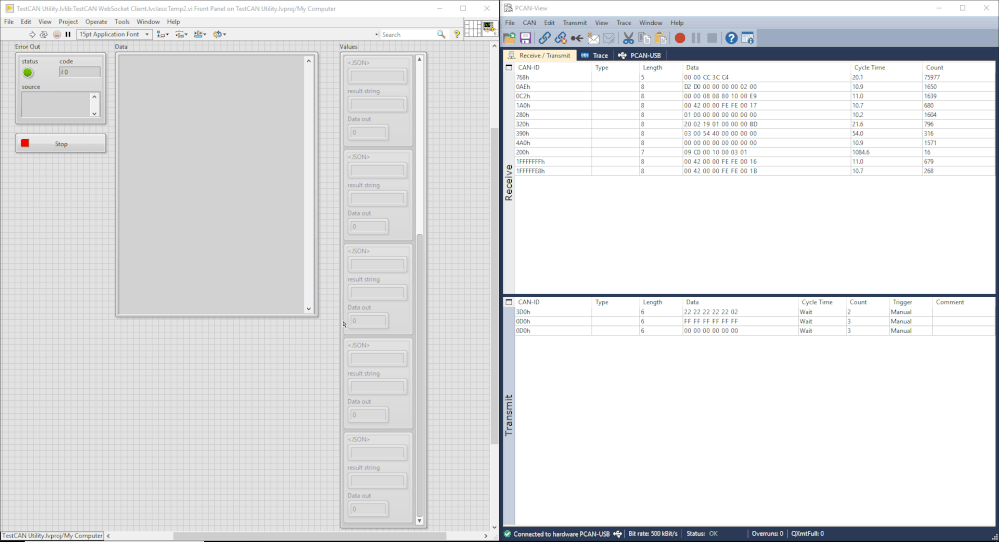

I've tried that library out and it's pretty nice! I've thrown together a prototype VI to hammer my webservice with HTTP GET's and bundle message definitions + their fields + the values of those fields:
Message 5 of 17

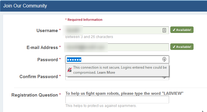

I would love to point out that the issue still isn't resolved on JKIs forums but in their great wisdom they don't support registering over an encrypted channel...

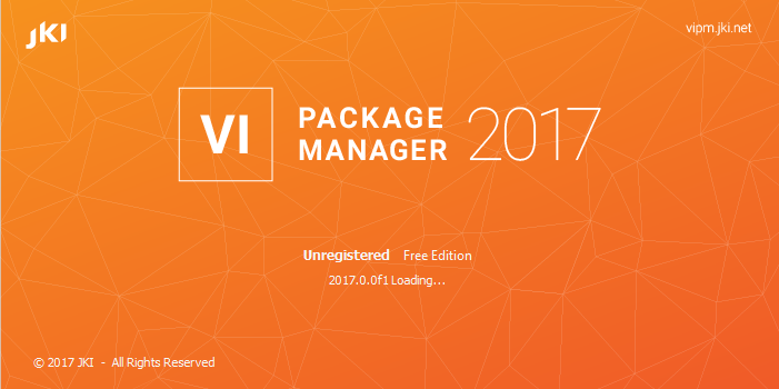

@drjdpowell wrote:
Are you sure you are using the bug-fixed version of VIPM?   It’s something like 2017.0.0.f1.   I know the bug is fixed as JKI asked me to beta test it with JSONtext (JSONtext includes example VIs that call VIMs, that wouldn’t build with the original VIPM version, but do with f1).
I am yes. "Check for updates" confirms I'm on the latest version.
VI Package Manager_2017-11-29_12-46-49.pngVI Package Manager_2017-11-29_12-46-49.png
Edit: The error I get now (Error 10) is different than the error I got when trying a similar thing with the previous version of VIPM. Same result though - can't call malleable VIs anywhere in my code.
