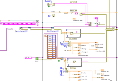

Hello, LabVIEW community, I am new to LV and have developed a VI which stores data in a .csv file. I am running into an issue to which I am not able to find a solution.
I want my data to look like what it is in "Expected.csv", currently looking like "Actual.csv"
I am reading data from different devices, all works well when all devices are connected and running but if anyone of the device is not operational the data shifts to the left and does not stick to the column I wanted it to be in.
I am not sure if I can share the VI as a whole so I decide not to but here is a snip that I have attached.
Thank you for your help.

Replying to myself for a probable solution:
Use case structure inside the "for" loop with error handler as input and when in error case condition send the predetermined array of zero to save in Excel so the other values do not displace. This sounds like a ghetto way to me, there should be a simpler method to achieve this.
The error input will be from the error-out pin of the communication block such as XNET, LAN etc.

Sorry, we are not really good looking at truncated code pictures with messy wiring (e.g. wires crossing underneath primitives, etc.).
Which part of the data is missing? From the looks of your files, it might be the data from "Signal Single-point", which would output an empty array, thus shifting the array from the lower FOR loop down by N positions. All you need is pad that array with zeroes (or NaN) to the known length (I assume you exactly know that length, 10?).
Also note that you don't really need any of these FOR loops, right? Shouldn't your shift register be initialized?
Do you have all possible permutations of instruments that can be down?
"Reshape array" can be used to pad/truncate arrays to a given size, so here's one possibility (adjust the precision as needed):

Here is the attached LabVIEW file that I have been working on.
To answer some of the other questions:
  1. Correct, the signal from "Signal Single-point" was missing because the CAN bus was not connected.
  2. The entire 3rd stanza is the correct representation of the behavior seen.
  3. It would be of the exact length of 10 always as I read 10 values from that data bus.

@Happy96 wrote:
Sorry I do not understand how a shift register would replace the For loop. The output is a 1D array of N elements.
You are mixing two separate statements!
(1) Your shift register should be initialized with zero, else the time will not start at zero if you do a second run during the same session. It will start at whatever accumulated time was left in the shift register from the previous run.
(2) Your FOR loops can be eliminated as follows. Now just pad the array to 10 elements as already shown in my earlier message and you'll get an array of 10 zeroes if the array is originally empty. If the array already contains 10 elements, they will be left untouched. If the array contains fewer than 10 elements, it will be padded with zeroes and if it contains more than 10 elements, it will be truncated to 10.  "Reshape array" is a wonderfully useful function!
And if you would pad after the formatting, you would get an array of 10 empty strings, which might be a better option if zero can also be a valid entry.

Thank you, I initialized my shift register and also removed the for loop.
This is what I ended up doing and it work as intended.
