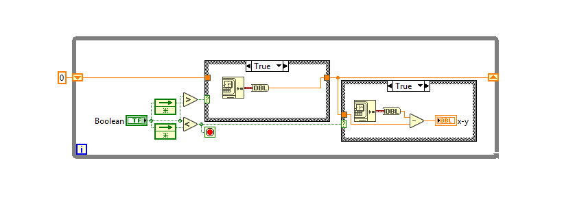

@kartiknattar wrote:
I guess this might help you.
Ohh thank you! But what I have to write in the both false case?

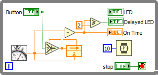

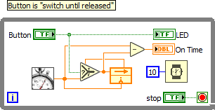

Here's what I would probably do:
Message 15 of 19
(3,077 Views)

thank you! It was of help but I would like that after 2 seconds the led lights on, not in the same moment of the boolean
Message 17 of 19
(3,067 Views)
A simple ">2" comparison in the time difference will do that.
