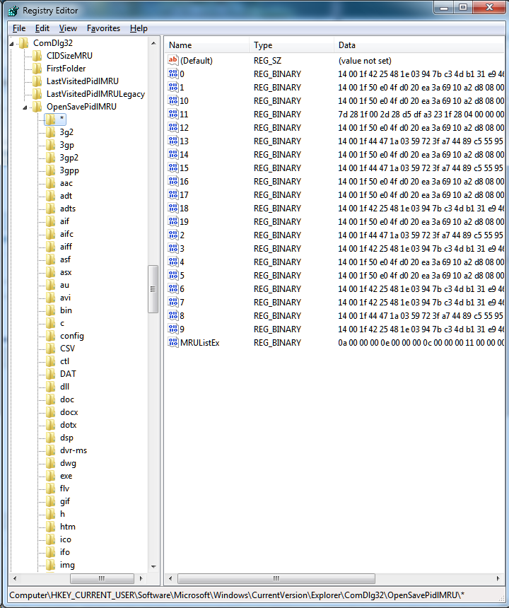

OK. I tried it on win7, so you will need to navigate to that key in registry and figure out if it is different in winxp.
Mine looks like this:

Can you see that subkey in your registry? As I said before, that bit is undocumented, I came across it in some random post when I had to do something similar. So it may be completely different in xp!

That's not right. You need to see how that value correlates to a value in the list. Can you post a screenshot of your registry like mine above?
If you look at my screenshot, my first byte is 0x0a which corresponds to 10 in the list, which is the list index of the last file opened in that extension subfolder.

That looks easy. So instead passing number string, just pass the first letter. Use string subset function or something similar (so in the sscreenshot it looks like f is your list index ) and you will have the file name from the next read function. You don't need to call shell32dll.
