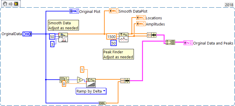

Try this and modify to suit you needs. The VI is back saved to an earlier version, so you should be able to open it.

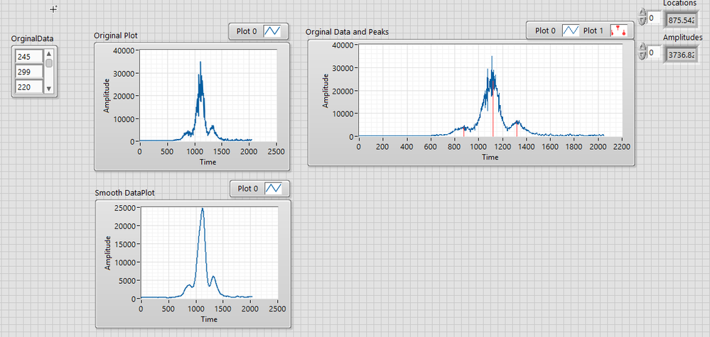

Hello mcduff,
The I wired what you sent me to my VI and I'm happy to tell you that it is now able to detect the peaks in real time. What I want to do now is to save the positions of the three peaks and their corresponding amplitudes for each scan. I no longer need the raw CCD data. Thank you.

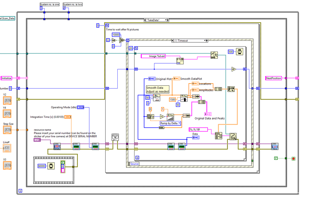

Hello mcduff,
I think I've done it. Please have at look at it for me. Thanks.

If it works for you then good. You do not need to display all the graphs I put in my example that I sent you, they were there for you to explore. But it is up to you.

I've just left the displays for now for comparison. Will do away with them later.
