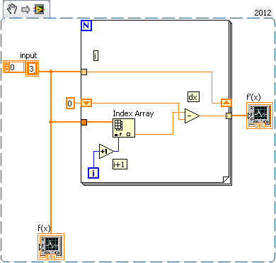

Hi ASH2020,
how about calculating the signal's discret first derivation; the derivation's sign should indicate a positive or negative slope.
Alex

I appreciate this! Remember: I mentioned about DISCRETE calculus.By the way, I didn't have this in school either Smiley LOL
