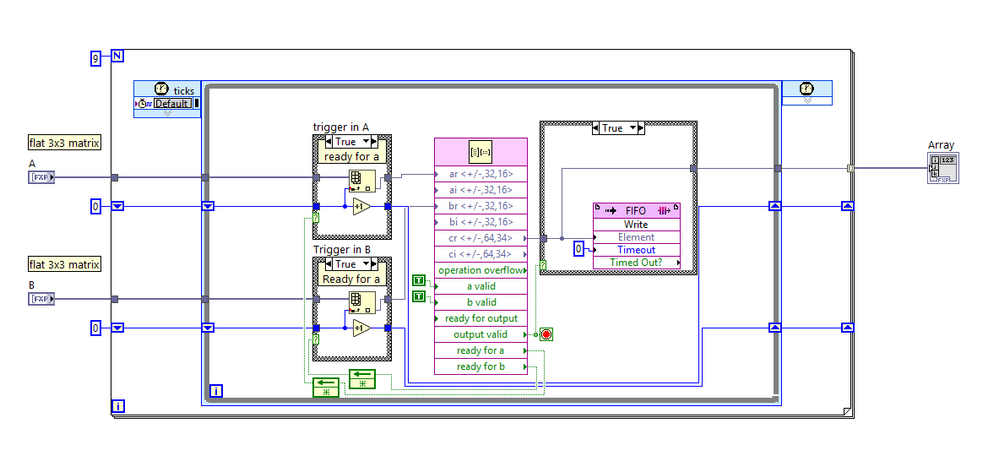

After looking around the forums, examples, and internet I have come to the conclusion that there is not a good resource/example for how to implement the Linear Algebra Matrix Multiply on FPGA. As I am unable to get this VI to work I was hoping someone could help me. In general I have two questions:
1) What am I doing wrong in the VI posted below?
2) What is the benefit of using this VI as apposed to writing my own code?
For my code, here is the code I have on my target. This is for a simple 5x5 matrix, fed into the VI 1 element at a time. I know the FIFOs and splitting the arrays work as they were from my prior home-brew matrix multiply code but I am always open to suggestions.
And here is the code I have on my host,
As per writing my one code, I did so following the example here, https://forums.ni.com/t5/LabVIEW/Matrix-Multiplication-in-LabVIEW-FPGA-space/td-p/3561369/page/3 but I would like to get this VI working just to compile it and see if it uses more or less resources than my home-brewed code.
Message 4 of 13
(4,921 Views)
That upper image of the FPGA code....... I don't think it will do what you think it should do.
While loop, Single-Cycle Timed loops, For Loops....... The whole thing only runs once...... You're either doing something incredibly brilliant or just plain wrong. I need a second opinion.

After looking around the forums, examples, and internet I have come to the conclusion that there is not a good resource/example for how to implement the Linear Algebra Matrix Multiply on FPGA. As I am unable to get this VI to work I was hoping someone could help me. In general, I have two questions:
2) What is the benefit of using this VI as opposed to writing my own code?
As per writing my one code, I did so following the example here, https://forums.ni.com/t5/LabVIEW/Matrix-Multiplication-in-LabVIEW-FPGA-space/td-p/3561369/page/3 but I would like to get this VI working just to compile it and see if it uses more or fewer resources than my home-brewed code.

From another thread (I messed up the original post) a comment was left stating,
"That upper image of the FPGA code....... I don't think it will do what you think it should do.
While loop, Single-Cycle Timed loops, For Loops....... The whole thing only runs once...... You're either doing something incredibly brilliant or just plain wrong. I need a second opinion."
I agree that in this configuration it looks like the matrix multiply function only runs once but I know that it must run over multiple clock cycles and when I collect all the "output valid" booleans I get multiple tags. So I assume this means the single cycle loop is somehow running more than once.

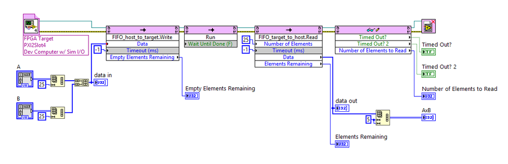

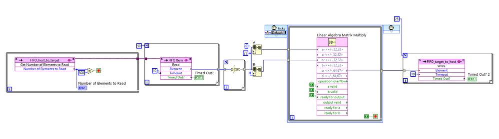

All,
I am still trying to work on this project, I have a code that is compiling and running but is not returning the correct values. I have attached the code to this post but it will not let me upload my project. All the project has in it is a target-to-host FIFO. Any ideas on what I could be doing wrong?

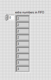

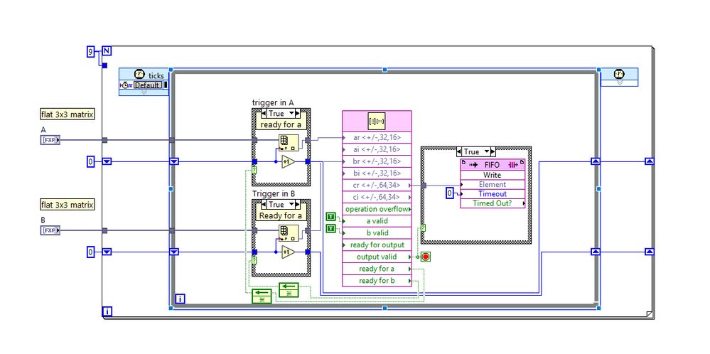

I think I have some extra numbers in my FIFO that are the reason I am getting the wrong answer. From the code below I should be putting only 9 items into the FIFO but I am getting 9 numbers that start in the FIFO every time even before I run the code from the host computer.
This is my code on the target where I
And these are the first 9 numbers that I get out of the FIFO. I have no idea where there are coming from. They do not change when I change my input and are in the FIFO before the invoke method on the host VI runs the code.
The next 9 numbers seem to be correct but I don't know what is causing these first 9 numbers.
