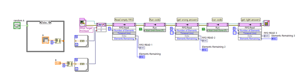

I seem to have a constant problem where the first time I call the FPGA code I get the wrong answer, but the second time I call it I get the correct answer. For example, here is my host-side code,
where I run the FPGA twice and read the FIFO after each time. The first time my answers are incorrect, the second them they are correct.

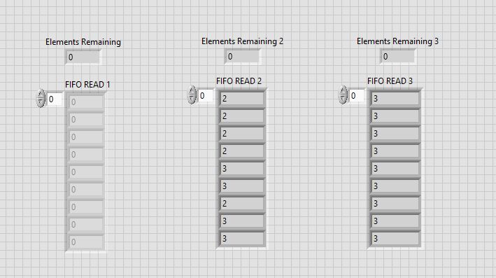

The answers should be 3s all the way down the array.

Sorry for the bump but I am still hoping someone could point me in a direction as to why my code provides the wrong solution the first time I run the code.
