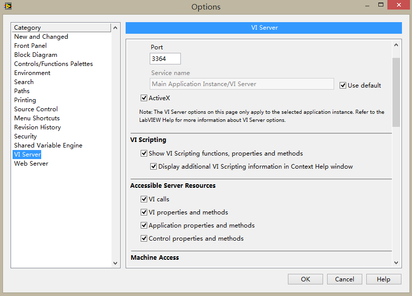

The solution that Darren presents, however, will not tell the difference between a typedef and a strict typedef (unless I'm missing something). If you have VI Scripting enabled (see attachment for where to enable this in the Options menu), you can expose the Is Typedef? property.
This returns an enum with the following values (as pictured)

Although this property is not settable in a VI at run-time, it should be readable.
Below is a picture of the Options menu where you can enable VI scripting
