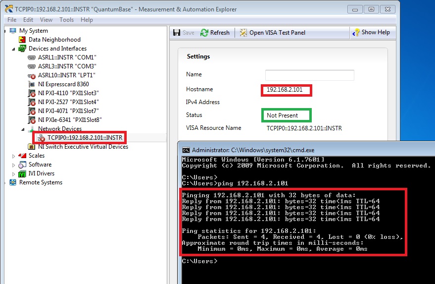

I have an ethernet connected device that I can ping in the CMD window but NI MAX says that it is not present...
How do I get NI MAX to detect this device as Present?
What am I missing?

Yes the device times out when I disconnect from it and ping then device.

What is the device that you are trying to connect to?
 NI device ?
It is a custom amplifier designed by the company that I work for. This device can be communicated to by some utility software
but I wish to automate this with Labview.  Because this is an ethernet device, it does not sow up in Windows 7 Device manager
and more importantly, it is not found in MAX.

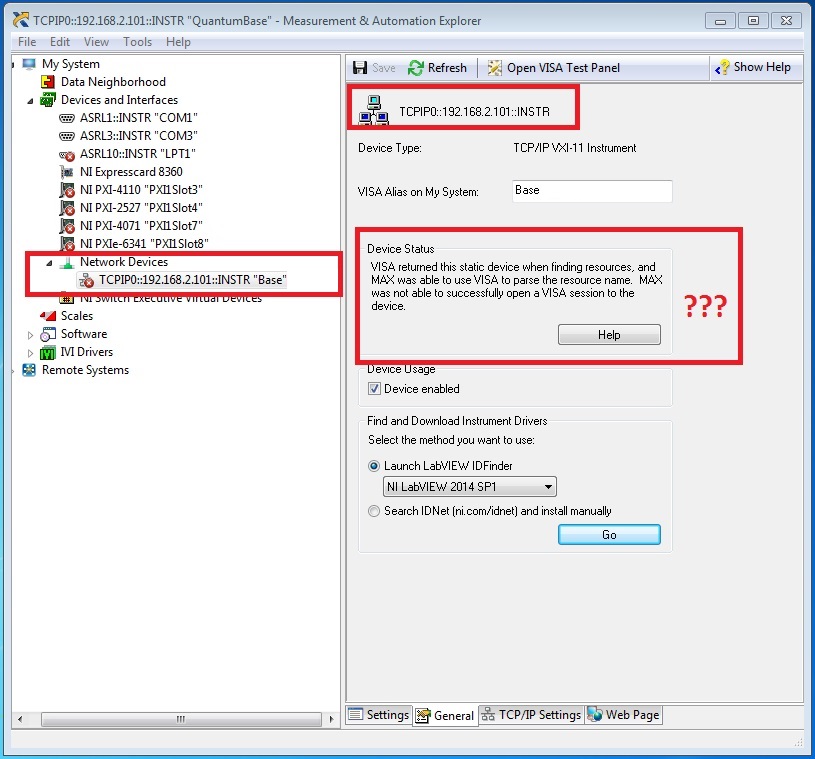

The MAX screen shown below states that it is a TCP/IP VXI-11 Instrument. I know that it is a TCP/IP device but am not sure what a
VXI-11 instrument is...
Do I need some special driver for MAX to see this device?
Thanks again

If the instrument's firmware does not implement the VXI-11 or the LXI standard, it will not be detected as one. You should try using the :RAW type of connection instead of :INSTR.
