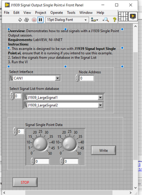

I am using the National Instrument 8502 CAN module and I want to send the request ID to j1939 to get the data from the xyz sensor. Which sample program should I use?
I am using this program but it is not working.
Thanks.
Message 8 of 9
(2,863 Views)
What is not working ?
Do you get any errors ?
Do you get any data?
Have you seen Hooovahh's CAN Blog ?
There you can learn all about LabVIEW and CAN.
Message 9 of 9
