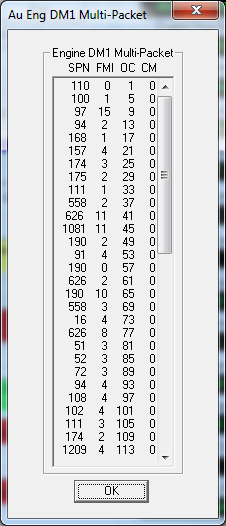

I have an AU electronics SAE J1939 simulator module that is supposedly putting out multi-packed DM1 messages like this:
and I am sending and reading SOMETHING of a response to the special request PGN 59904 (00EA0016) using multiple software tools in LabVIEW and CompactRIO's and 9853 High Speed CAN modules (down to the FPGA level) yet I don’t receive but a fraction of the SPN’s (Suspect Parameter Numbers) or the FMI’s (Failure Mode Indicator) that I expect or what’s on the list shown.

Think I have it figured out, I was limiting my packets of DM1 messages (multi-packet message) to a 64 bits when it should have been ALL and can be much more than this. The simulator I have puts out approx, +250 bits for a multi-packet broadcast message (+37, 8 byte payloads) to get the info in the pickture I sent before.
As long as I sent the REQUEST correctly (FECA for DM1), this seems to work.
