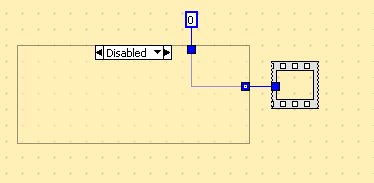

Diagram Disable cosmetic bug ?
Start from here (attached VI):
switch to the Enabled case and wire the top tunnel to the right tunnel:
Oops! While is the wire misaligned?
The strange thing is that this problem does not occur if you wire from right to top.
Tested in LV 2011.

Actually, this also occurs with For Loops as well:
(you need to first connect the array to the Loop border. Then in a second step, connect the autoindex thingy to the other side - I know this is not what you would do normally, but this is just illustrating the bug).
Oddly enough, this does not appear to be the case from below:
 ...for the For Loop. The Disable Structure does that from below:
(3,232 Views)

I am using XP lastest SP. I'll try on a Windows 7 machine when I'll get a chance.
Clean up results in this:
(3,168 Views)

Thanks for clarifying that with me. With regards to the cleanup, I was wondering if you could select only the misaligned wire and then run the cleanup. The logic behind that was to see if LabVIEW recognizes that the wire is actually offset in that specific instance. However, from the snippet you posted, it does indeed look like the cleanup re-aligned the wire, although in a completely different orientation.

Just selecting the misaligned wire and "cleaning" does the job.
I confirmed the behavior on a Windows 7 machine running LV 2011.
