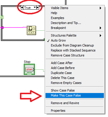

Your "Not equal true" is pure Rube Goldberg (Same as a "not"). Just wire to the case structure and fill the two cases accordingly. You can even swap the case content by right-clicking the case structure.

Apologies, I thought it was just the screenshot. Yes, yours works exactly how it's supposed to thank you very much. The feedback node was throwing me off because I didn't know you could change the direction (I do now). And I used the 'not equal to' initially because I also thought, wrongly, that it wouldn't take into account the tolerance if it was greater than 25 (not sure if I fully understand why).
