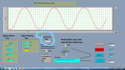

I was sampling a 500Hz and 1,000Hz signals with 500Hz sampling rate (low sampling rate on purpose, in order to check sampling limitations and aliasing phenomenon).
In both cases, LabView returned a 5Hz signal frequency, however the real-time display showed a difference between the two signals. Also, when trying to plot the output vectors on Matlab, I get different frequencies.
What could be the cause for the mismatch between the presented frequency and the graph?
attaching printscreens of both cases. I am aware that the printscreen for 1000Hz signals shows different value in number of points to buffer, this wasn't the cause, as I did wait long enough.
1,000Hz signal (left picture):
500Hz signal (right picture):

You didn't attach the VI, just a picture of the front panel. I'm not clairvoyant, so I don't know what is actually going on. Looking at the settings on the front panel, I can try and make an educated guess.
You are sampling at 500 Hz. You have another field "vector length for FFT" set to 100. BIN_WIDTH = Fs / N, or as in your case the bin width is 500Hz / 100 = 5 Hz. That is your SMALLEST frequency resolution of the FFT. I'm assuming that is why all you answers equal 5 Hz.
Try increasing the "vector length" to at least 1000. That will give you a 0.5 Hz resolution. Depending on your actual data, you may need to increase it even further.

Thank you very much, that was my problem!
