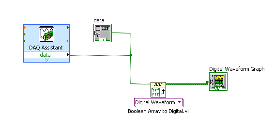

I have a Picoturn which measures RPM of the turbine. I have connected the digital output from picoturn to Port 0 and D.GND port in BNC 2110. The BNC is connected to M-series PXI-6251 card. From the DAQ assistant I am getting 1 and 0 when I run the turbine. So I connectedd DAQ assistant to "boolean to digital convertor" and then connect it to digital waveform graph but I don't see anything in the digital waveform graph.
I don't konw whether I am doing it right or wrong. I just need rpm from this.

I am sorry the wires are broken in the previous vi, here is the snipshot of the vi.Digital_RPM.PNG

This is likely close to what you want.  You didn't provide enough information but it is a start.  You didn't say how often you expect to see pules.  If at your fastest spinning RPM you see a pulse once every 1ms, then you'll want to sample at least once every 0.1ms.  This is a constant on the block diagram which is sample rate, which I set to 10KHz.  You'll also need a samle duration and I set that to 1 second.  Too fast and you won't get accurate readings, too slow and there will be an averaging affect.  You also didn't say how many pulses you expect to see in one revolution.  I set it to 8 as a front panel control.  I also back saved into 2010 but I don't have 2010 so no idea if it works.
