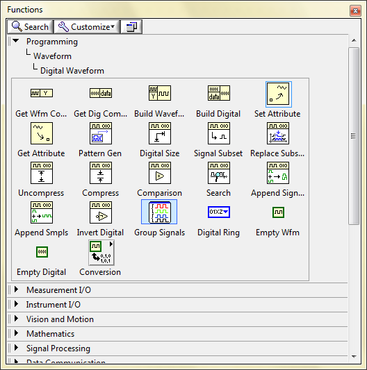

You're simulating an analog signal and the DAQ Assistant is configured to output a digital signal.
To create a digital waveform, look for an example or checkout functions available in 'Digital Waveform VIs and Functions' sub-palette.
Digital Waveform Palette
Or you can also think of spending some money on buying 'NI Digital Waveform Editor'.
