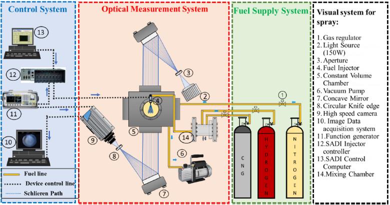

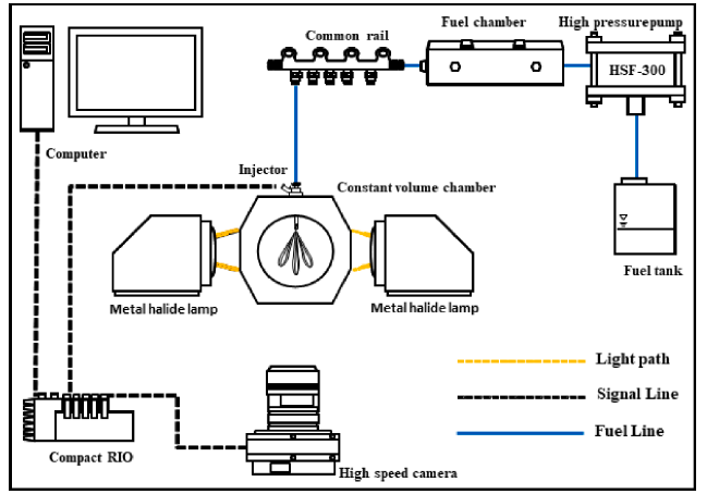

- I want to build a test rig to investigate the hydrogen fuel injection process. So, I will use an injector and of course I will need to adjust some parameters.
I don't have an ECU. I ask about some off-the-shelf ECU.
I think the next figure will help you to understand better. I want controller like it.

Ok Now you need to break each one of these things down that you want to control:
How does it work?
What do you need to control it?
What type of data do you need from it?
Look up each component. You should be able to find the information you need on line. You need to find out how to control each one. From that point you need to build a system that allows for control of each system that you want to control. This sounds like a big first project. If you find the info for the first part we can help you get started. I would recommend that you look at the basics training for LabVIEW before you start.
