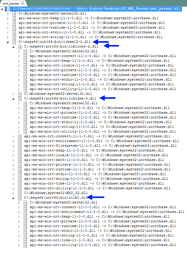

The only dependencies I see are the following:
So, these four files shall be suffcient:
17.12.2024  20:10         1.135.869 libiconv-2.dll
11.04.2025  14:19           189.434 liblzma-5.dll
18.02.2025  21:51         1.309.996 libxml2-2.dll
23.01.2024  09:51           100.279 zlib1.dll

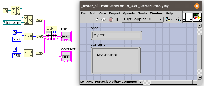

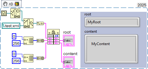

Snippet and works:
Test project (including dependent DLLs) is in the attachment.
Update: Sorry, I didn't realize you're using Linux. I don't have access to a Linux system at the moment, but it should work similarly in general. I can prepare a version for Linux as well, just not right now.
(819 Views)
In general, I'm not sure how Linux is applicable here (maybe the initial question was AI-generated), but anyway, I've checked this and, in general, it's almost the same.

and works exactly same:
